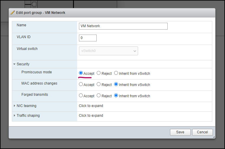

AminRamadan
In case , if anyone wondering how to change the Promiscuous mode from Exsi, please see the pic.
