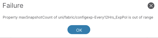

However, when you try this:
Whoopsie!
So it would seem that "global-limit" is < 21
SO - let's hit the online documentation: (via https://YourAPIC.IP/model-doc/#/objects/configExportP/properties )
OH DARN - there's proof that the maximum value you can push into there is 10 anyway. (I was able to successfully post the above with a value of 10 for maxSnapshotCount but could NOT post it when I incremented to 11)
So you are out of luck with trying to put 21 there!
Whoopsie!
