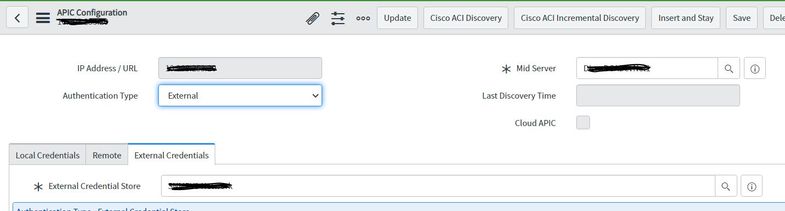

I've tried all the steps above and made sure the credentials don't have special characters. We used the Authentication Type "External credential" and from the External credential tab, we selected the credential we created in Discovery > Credential. See below:ext credential.JPG
