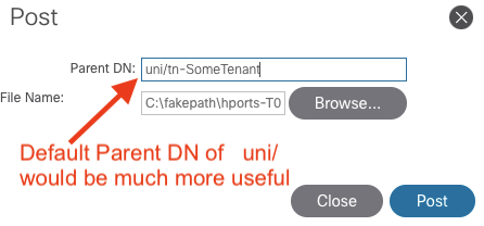

If these become the defaults, then it will be MUCH easier to download configs and post them back - except for one more little annoyance that comes when you right-click on an object in the APIC GUI and choose Post
The Annoying part about this is that the default Parent DN is based on where the right-click was pressed - which almost NEVER where you want it to be pasted.
image.pngA default Parent DN of uni/ would be much more useful
RedNectar aka Chris Welsh.
