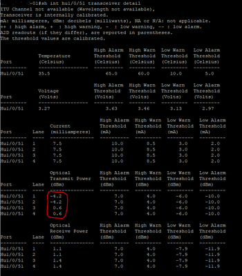

I am troubleshooting an issue with an L3OUT that is bouncing/flapping periodically.  It looks to me to be a physical issue but I am struggling slightly.  The ACI switch is a Nexus 93180YC-FX which is connected to my core which is C9500-48Y4C.  Both ends are using genuine Cisco QSFP-40/100-SRBD and short (eg 10-15m) OM4 patch cable directly between the two switches.
On my core switch, I see some odd TX optical levels on lane 1 and 2 but DOM is not enabled on my fabric so I can't see the RX values on the ACI end.

Aside from that, does anyone with experience of multi-lane optics know if this is a clear fault with the transceiver?
