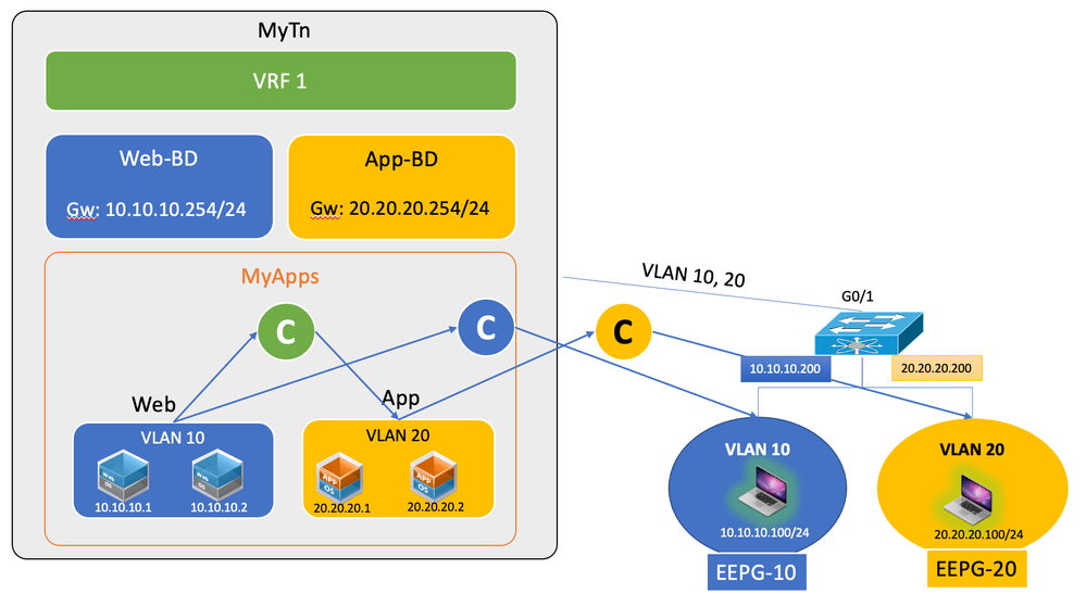

Have you explored L2Out for the migration?
Please check the example digram below, providing a high level diagram of L2Out-BD extension for migration:

.... Continuing the above, about L2Out and L3Out:
  • L2Out is primarily used for extending VLANs and enabling Layer 2 communication between the legacy network and ACI during a phased migration.
  • L3Out is used for routing between the ACI fabric and the legacy network or external devices.
  • In most migrations, both L2Out and L3Out are used together to ensure a smooth transition from the legacy NX-OS network to the ACI fabric.
