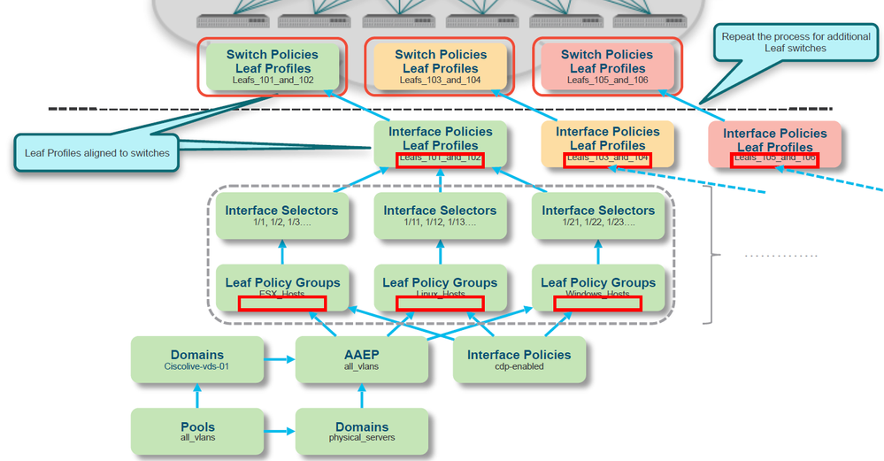

In my projects, I configure a single Policy Group for each type of server. For example all ESX servers will have one PG., regardless if the interface is mgmt or data.
My config looks similar to this:
BTW, if you leave the speed on "inherit" you do not have to worry to much about static speed configuration, because speed will be inherited based on transceiver connected on the port.  Also you can use auto-negotiation for RJ45 ports.
Stay safe,
Sergiu
