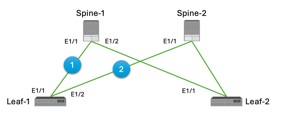

Hello all,
Currently my Leaf uplink/Spine downlink ports (so the connections b/t the Leafs and Spines) are currently running on 40-gig BiDi SFP's, and I recently purchased new compatible QSFP-100G-SR1.2 SFP's to upgrade them.
My plan is to swap the SFP's for a single Leaf/Spine "connection" at a time, e.g. swap the SFP on "Leaf-1 uplink-1" and then swap the SFP on the corresponding "Spine-1 downlink-1", then make sure that link comes up before moving to the next uplink/downlink connection (e.g. Leaf-1 uplink-2 and Spine-2 downlink-1).
My question is, would this plan of swapping a single uplink/downlink connection at a time cause any impact to endpoints in the fabric? Trying to decide if I need a maintenance window to perform this work (I know I know, we "always" need a maintenance window ;- ), or, if there will be no impact to endpoints with this method, if I can treat this like other "operational" work and do it as part of the regular work day. I had a previous co-worker who said these ACI uplink/downlink SFP swaps could be done during the regular work day, but I wanted to check with the community for your thoughts before I proceed. Thanks!

@vv0bbLeS  Go ahead your SFP replacement strategy is outage free strategy. In order to avoid any bandwidth issue during prodution hours it's suggested to choose less production traffic time. Below is the diagram:
Keep a verification time between Step 1 & Step 2
