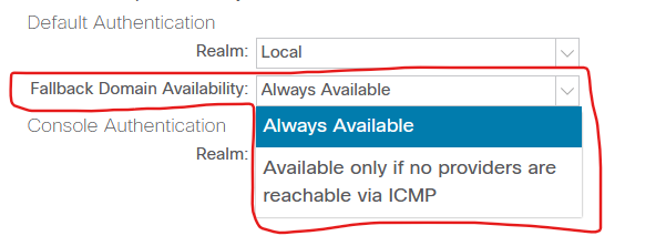

By default, the fallback login domain is the local realm. If you haven't change it, then first step is passed.
Second thing which is important, is the setting of "Fallback domain availability" which modify the activation of the fallback domain:
  • Active if ICMP health check fails—The fallback domain becomes active only when all AAA providers in the Default Authentication Realm fail the ICMP health check.
  • Always Active—The fallback domain is always active.
The default setting is Active if ICMP health check fails.
I would suggest you enable the "always available". It is a safe mechanism in case of problems with AAA providers.
To access the fallback domain, indeed you have to manually invoked to be utilized. It can be done so with the following syntax:
  • From the GUI, use apic:fallback\\username.
  • From the REST API, use apic#fallback\\username

Sergiu.Daniluk
Stay safe,
Sergiu
