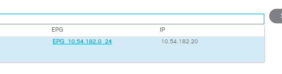

For example, I know for sure that IP addr. 10.54.182.20 is within ACI environment because I do find this IP in EP tracker:
By issuing #show endpoints ip 10.54.182.20 and #show vpc map commands on APIC CLI I concluded that 10.54.182.20 exits via interface eth1/10 on leaf switches 1750 and 1751.
