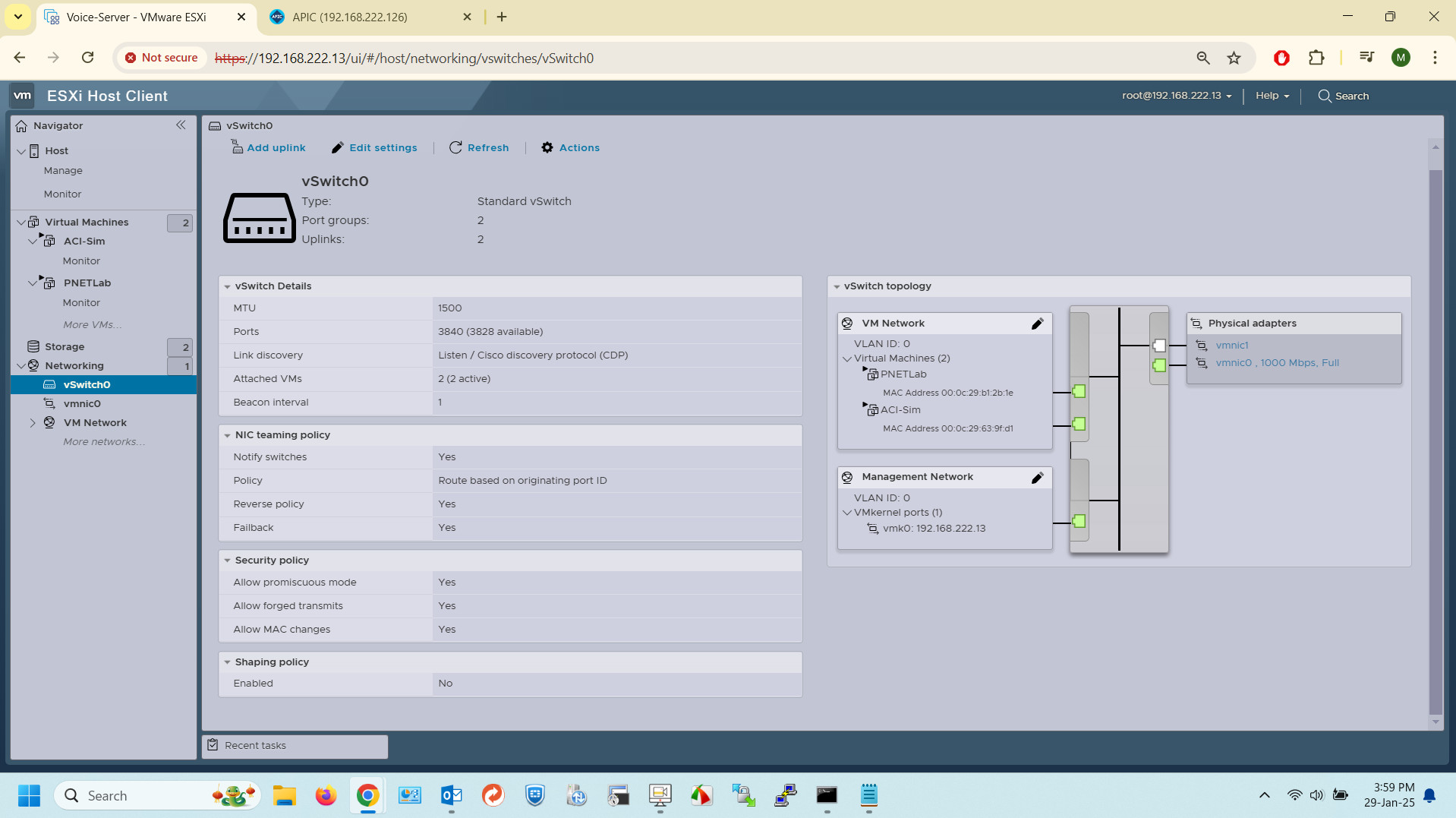

Thank you for the reply!  I compared your screen shot to what I had configured (see screen shot).  I set Promiscuous mode to Accept but I did NOT set MAC Address Changes and Forged Transmits to Accept.  When I set those to Accept, I was able to ping the simulator.  I am pretty literal so I only changed the Promiscuous Mode as called out in the documentation.  Mentioning the other two settings in the documentation or adding a screen shot of the settings in the documentation couldn't hurt.

If you have not already done so, check your vSwitch in VMware and set MAC Address Changes and Forged Transmits to Accept.

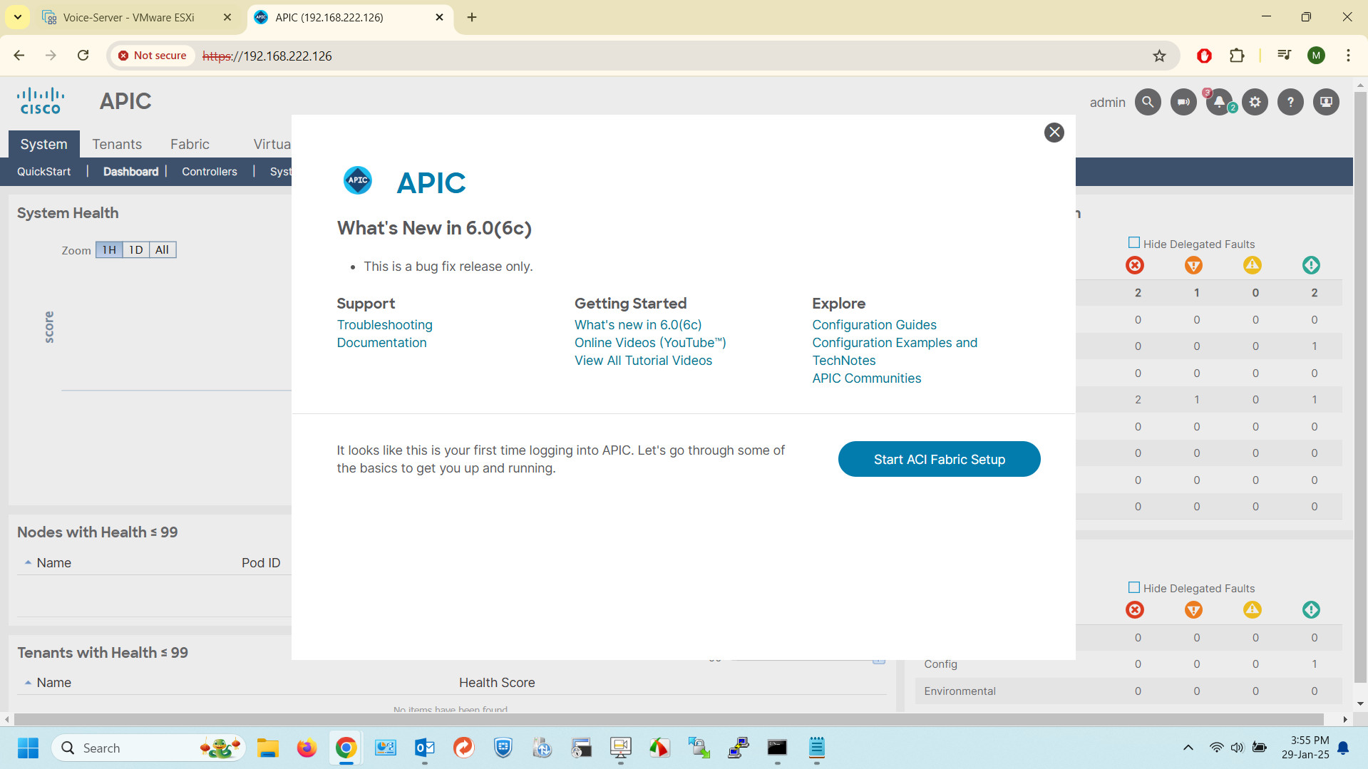

This really helped me and I was able to get the GUI of my APIC first time ever.

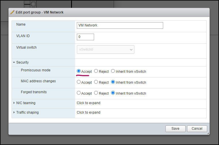

AminRamadan
In EXSI, I succeeded by changing the port-group of network to Promiscuous mode as it is shown in pic.
