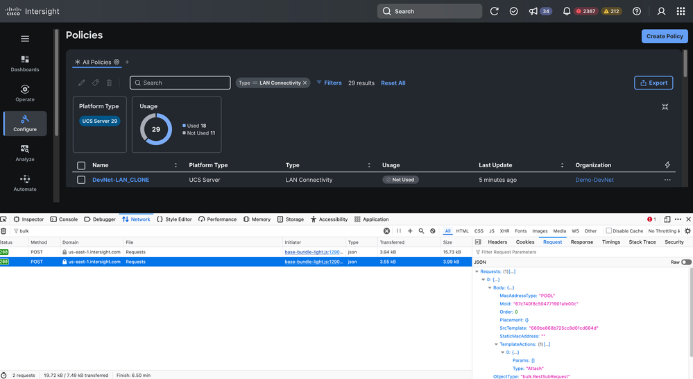

ok how do i modify it to just attach vnic to vnic template? Both already exist
I'll work up an example of attaching an existing vnic to a template.  A browser developer console will show the payloads needed for the bulk/Requests API resource.
