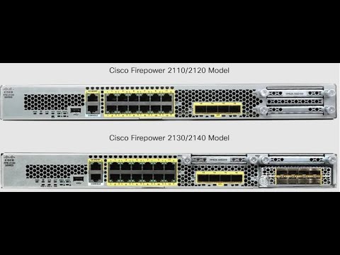

In this Cisco Tech Talk, we walk through the process of completely reimaging Cisco Firepower Threat Defense (FTD) devices in the 1000, 2100, and 3100 Series. Learn when and why to reimage, how to prepare, and how to recover configurations for a smooth re-deployment. Related links: Cisco Secure ...
