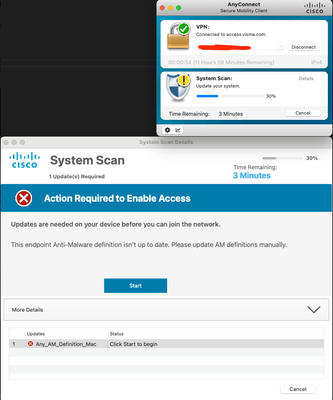

When I try connecting to VPN all goes smoothly until System Scan 30%.
If I click "Start":

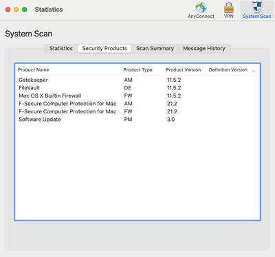

AnyConnect has identified F-Secure:
