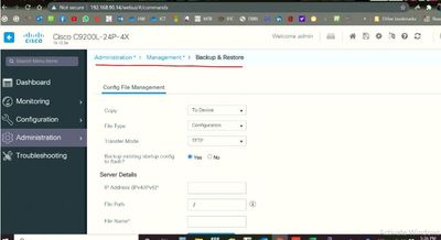

thanks a lot for the reply. but i am not getting software upgrade opting in administration tab. can you please tell me exactly where it the option.
FYI, i have went to Administartion >> Management >> Backup & restore
here i only see config file management (which is related to configuration but not firmware upgrade )
also another thing is, i have downloaded the latest firmware file (.bin file) from cisco site. will it work okay ?
