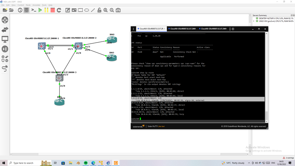

this lab for match interface in NSK
I use
redistribute direct route-map MHM
under EIGRP
route-map MHM permit 10
match interface e1/5
and you can see the EIGRP only advertise the prefix direct connect to this interface e1/5
I use
under EIGRP
