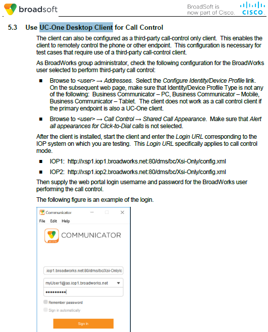

I need to run UC-One Desktop Client in call control mode.
Found some instructions but don't understand how to apply them to Broadworkds sandbox solution.
Which Login URL should I enter to run in call control mode?
As I understood I should enter the Login URL which specially applies for call control mode not usual Login URL.
Or maybe now there is another way to do this?

As of now, communicator for call control is not supported.
OK. Thanks for explaining.
Is there a plan to support this in the future?
The reply is incorrect - communicator xsi only operation is supported - it requires a separate device profile type from your full UC1 device profile type.  I have attached a writeup that explains it all.  Hope this helps.
Thanks for information.
