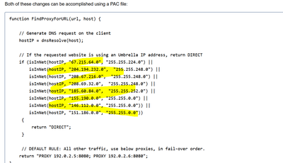

@ccieexpert I just need to confirm the IPS on this Pack file, this IP is related to umbrella servers and must be set on the Pac file so the traffic will Pass through the proxy after I added them, but I will use the Pac file if we use the explicit proxy and we will not use the Umbrella VA , so is that correct

@ccieexpert
i mean if I use explicit proxy on my environment using PAC file will I need to exclude the below IP or not
related to this article
https://support.umbrella.com/hc/en-us/articles/230563527-Using-Umbrella-DNS-with-an-HTTP-proxy
