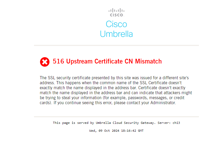

Hello, here is a step by step example of what I'm seeing... using incognito mode in chrome.
  1. Using Umbrella dns based protection.
  2. Visit http://exampleadultsite.com
  3. In incognito mode... I'm seeing a redirect to https at this point.
  5. Get Umbrella block page. (https://bpb.opendns.com/b/https/exampleadultsite.com/) (notice changed to https)
  6. Bypass using account or code.
  7. Get bypass confirmation page.
  8. Click "Continue browsing at exampleadultsite.com, which is proxied to be able to bypass the block.  URL starts with https://exampleadultsite.com/_bpb/1/[lots of extra args]
  9. Umbrella servers see the mismatch and return "516 Upstream Certificate CN Mismatch" error page
I then tried it in a new chrome profile... and it worked fine.  No https redirect for some reason???
Maybe incognito mode is more enthusiastic about forcing to https?  Maybe http links are treated differently than manually typed in URLs?  Maybe I'm hitting chrome caching the redirects which I remember being a PITA in some situations.
In any case, it seems like Umbrella's test site should be setup to work in https mode.

One last note, I opened a ticket about this yesterday and just received this, so hopefully the next time the certs get issued they will have the test site SANs.
Thanks for bringing this to our attention. After verifying the certificate errors, it turns out the engineering team is aware of this issue with test sites and they should update the certificates for them soon.
