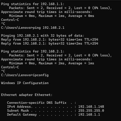

Hello @Lalaram Raika ,
are the PC's in the different VLAN's able to access external resources like the Internet?
I would also check the firewall settings on the PC's - maybe disable it to test connectivity between PC's in different VLAN's.
Also, are there any access lists configured on the SVI's?
And also, can a PC in VLAN 1 for example, ping
1. it's own gateway 192.168.1.1
2. ping the default gateway of VLAN 2 - 192.168.2.1
If both pings are successful, then check the firewall config on the PC's.
Regards, LG
*** Please Rate All Helpful Responses ***
all are fine but still not resolved

As i already shown you in the configuration  route is available , svi has ip , each user has gateway as svi ip and all uplink and downlink are int trunk mode, each switch has vlans and vlan1's user is reachable to gateway to another vlan's gateway

What about:
Can you confirm that both pings work?
