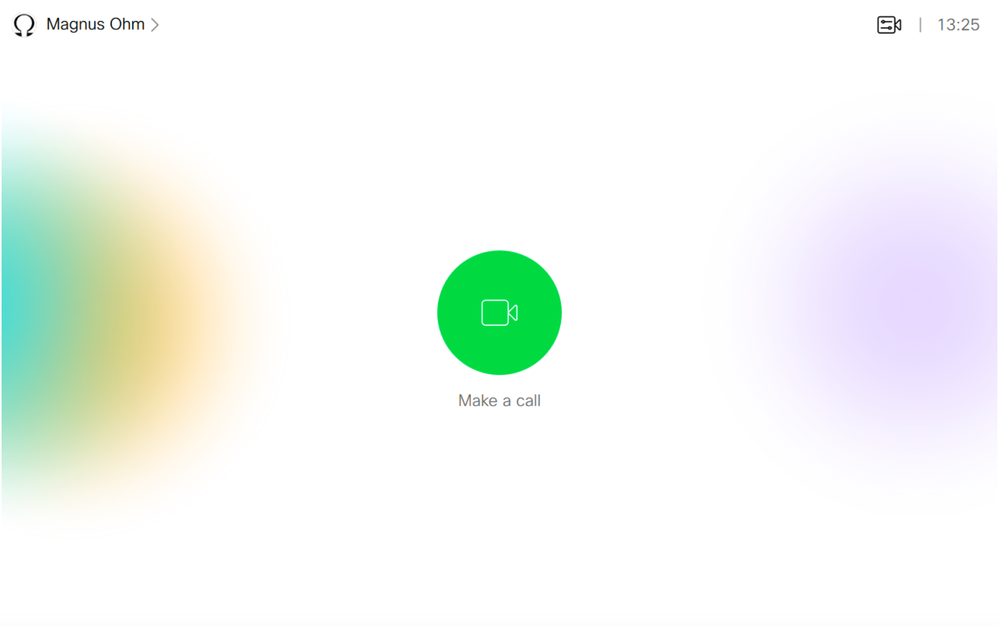

For now only the bot is in the space, so I will add my self to the space using the macro. The Webex Teams API uses POST to add new members.
function spaceAddMembers(roomId, email) {
  payload = JSON.stringify({
    'roomId': roomId,
    'personEmail': email
  sendWebexTeams(wxAPIs.members, 'Post', payload);
spaceAddMembers("Y2lzY29zcGFyazovL3VzL1JPT00vZDlOWEzZTAtNmZlOC0xMWU5LThlNWMtZGI2ZGMwZWMyYmUw", "mohm@cisco.com");
With the above the server will return to me the membership ID (also returned on list members) which I can use to modify moderator priveleges with. So I want to make myself moderator of the space, the bot aill automatically get moderator as well since the mod flag was set through the API.For this operation the Webex Teams API expects "PUT".
function memberSetModerator(membershipid) {
    'isModerator': true,
  sendWebexTeams(wxAPIs.members + '/' + membershipid, 'Put', payload);
memberSetModerator('Y2lzY29zcGFyazovL3VzL01FTUJFUlNISVAvNzkyMDY0ZmYtMmMxOS00MmY4LWI2NTEtNmQ4NGZlMmNhMWM2OmQ5YTlhM2UwLTZmZTgtMTFlOS04ZTVjLWRiNmRjMGVjMmJlMA');
The bot changed our status to moderators!

I want to create a custom UI for my employees where they can dial into specific meeting room that is used regularly. We don´t make external calls anyway and it's only between the meeting rooms that calls take place.
My UI looks like the above on the Touch 10.
xConfiguration UserInterface Features HideAll: True
After issuing the command above the UI will look like this:
