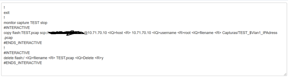

This is the feature template I made.
It copies the file adding the ip address, but I don't know how to add the date (or a sequence number or something like that) at the end.

This is the variable:
And this is how it is copied to scp server:

I do not think it is possible to do via Prime UI. It allows to add a variable to your script, but its value will be the same for all scheduled instances of the job.
But this can be done via Prime API. You can add a variable to your CLI template (integer or string) and prepare external script that will deploy this template.
