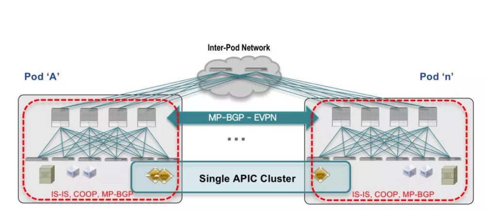

Before we dig in, let’s examine some of the benefits that come with deploying ACI Multi-Pod.
  • ACI Multi-Pod allows for fault isolation of Control Plane Protocols inside of each respective Pod (IS-IS and COOP protocols operate intra-Pod). This is important because it ensures that a routing or protocol issue in one Pod will not take down the entire fabric.
  • Centralized Management through one APIC Cluster (Cluster of 3, 5, of 7).
  • Eliminates fate sharing if one DC goes down
  • End-to-end Policy Enforcement
  • Pervasive GW across all leafs in all Pods

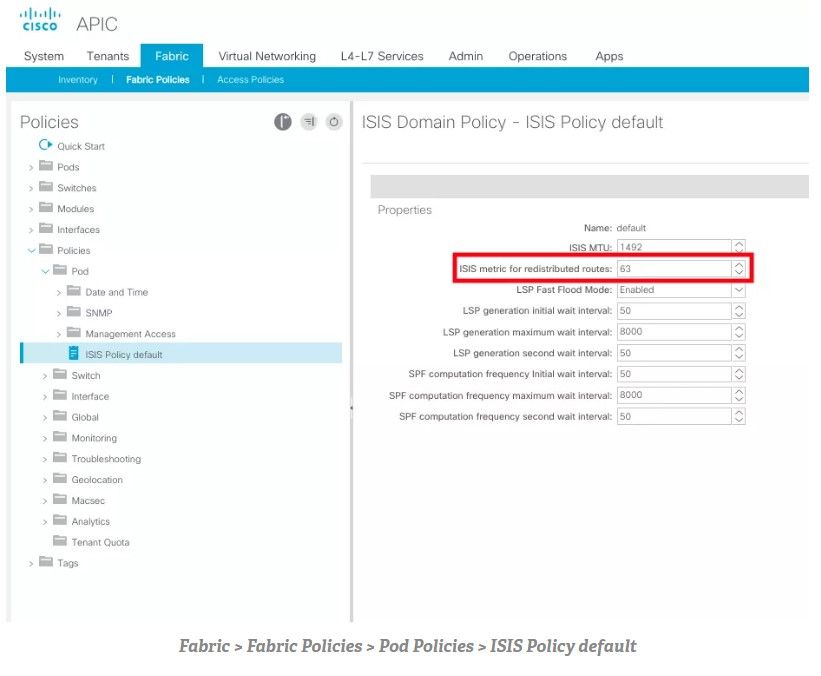

In a Multi-Pod setup when a Spine switch is rebooted, traffic should not flow through the switch for 10 minutes after its routing protocol adjacencies come up. This is achieved by advertising a high metric into OSPF and IS-IS for 10 minutes. This works fine for OSPF, but not for IS-IS. The problem is that within the Cisco APIC, the default metric for routes redistributed into IS-IS (such as the remote POD TEP pool) is 63.
This also happens to be the max-metric that can be set for redistributed routes into IS-IS in Cisco APIC. So when the spine that was just rebooted comes back up, it cannot advertise a worse metric than the default, which causes all of the leaf switches immediately to install the switch as an ECMP path for the route even though things such as COOP might not have converged yet. If traffic is hashed to this ECMP path, there could be traffic loss for several seconds.
This issue can be seen in any Multi-Pod environment. Beginning with APIC 3.0 code, users have a way to change the default IS-IS metric to prevent this issue.
To change the default ISIS metric for redistributed routes, go to Fabric > Fabric Policies > Pod Policies > ISIS Policy default, and change the value from 63 to 32.
