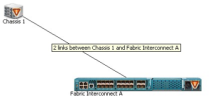

Connecting UCS-6120XP Switch to UCS-5108 Chassis
Now it is time to configure the Unified Fabric Interconnect Switch (UCS-6120) Port to be connected to the Chassis.
Assuming that the twinax cable is already connected between the chassis and the UCS-6120, configure the port as follows by selecting Configure as Server port.
  • Since we have two ports on UCS-6120 connected to the two ports in the same fabric interconnect, we have selected second port as well
  • Note that the same task can achived using differen GUI options so your seteps may vary but the objective is same to set port as Server Port
  • And now when you look at it in the Main Topology View window, you can see two links connected
And the overall connectivity with the backplane port as well looks like following

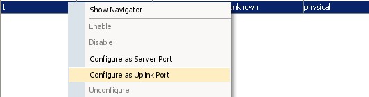

Connecting UCS-6120XP Switch to Uplink Ethernet Switch
Each UCS Fabric Interconnect provides ports that can be configured as either Server Ports or Uplink Ports. Ports are not reserved for specific use, but they must be configured using the UCS manager (preferabiliy). You can add expansion modules to increase the number of Uplink Ports on the Fabric Interconnect. LAN Pin Groups are created to pin traffic from servers to a specific uplink Port.
UCS-6120XP ports are 10GE ports and hence the regular SFP transceiver cannot be used to connect it to the uplink ethernet port. Unlike 10/100/1000 bits ethernet port, 10GE ethernet port cannot do auto-negotiation of speed and duplex and hence the UCS-6120XP port should be connected to the 10GE uplink ethernet port. A 10GE transceiver (e.g SFP-10G-SR) is required on the UCS-6120XP switch. Make sure to order it as part of your UCS order because the Netformix ordering tool will not give you any indication if you had missed it.
On the CAT6K switch, X2-10GB-SR SC interface type transceiver can be used and a regular LC-SC fiber cable can be used.
Or you could have CVR-X2-SFP10G adapter inside tha X2-10GB-SR to convert it into a LC type connection and can use regular fiber cable or twinax (SFP-H10GB-CU5M) cable to connect UCS-6120XP to uplinl Ethernet Switch.
The port configuration on UCS-6120XP are done at the Service-Profile vNIC level. VLAN trunking could be seleted either YES or NO. In a typicaly deployment this setting should be set to YES. And on the CAT6K switch side the port should be configured as a trunk port. Following is an example of CAT6K configuration
interface TenGigabitEthernet5/2
description UCS-6120-XP Fabric Interconnect Port 20
switchport
switchport trunk encapsulation dot1q
switchport mode trunk
spanning-tree portfast edge
show interfaces tenGigabitEthernet 5/2
TenGigabitEthernet5/2 is up, line protocol is up (connected)
  Hardware is C6k 10000Mb 802.3, address is 0023.04d7.1d5d (bia 0023.04d7.1d5d)
  Description: UCS-6120-XP Fabric Interconnect Port 20
  MTU 1500 bytes, BW 10000000 Kbit, DLY 10 usec,
     reliability 255/255, txload 1/255, rxload 1/255
On the UCS-6120XP side the steps are very similar to configuring the server port. In the UCS Manager GUI, right click on the port that you want to configure as a uplink ethernet port and just select the option.
Once the connection with the ethernet switch is established the port will be moved under the Uplink Ethernt port group and will show enabled/up state as follows.
