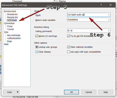

WinSCP configuration required for Nexus 9000
feature scp
feature bash
Configuration required in WinSCP
Note: We can also just use "run bash" without the "sudo su" part, this has been lab tested too and appears to work as expected.
After these configuration changes are made you can click "ok" then proceed to connecting to the device as per usual.
HTH
Regards,
Jason.

Huge thanks Jason !
jacob_zhu
Thank you, Just I need
krozier
The steps worked perfectly. Thanks!
jm583q
cannot make it work for Cisco 9k series XE, for XR is working fine
Mike Sandvik
I am curious if this method will work on MDS switches as well
kalbritt
Great work!  I also had to use feature scp and feature bash.
rmaier8509
Thank you so much!!! I was banging my head on a wall for days trying to get this to work.  Feel much better now
