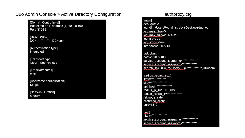

I found a very interesting and wonder article in “Duo Authentication Proxy - Reference”.
We do not recommend installing the Duo Authentication Proxy on the same Windows server that acts as your Active Directory domain controller or one with the Network Policy Server (NPS) role. If you must co-locate the Duo Authentication Proxy with these services, be prepared to resolve potential LDAP or RADIUS port conflicts between the Duo service and your pre-existing services.
In my opinion, there should be no port conflict if AD and DAP are built on the same Windows server. In fact, I tried that with the attached my configuration and setup image and it worked exactly as I expected it to.
Does anyone know why it is not recommended? Has anyone done a similar test and encountered any problems?
Regards,
Raima Ito

Hi Raima,
I can help clear up why we recommend the above.
There are a few of reasons for this recommendation.
In general it is best practice to keep your DC as clean as possible as it is a critical piece of your domain architecture.
Having a distinct proxy and DC server, or more to the point multiple of each will allow for high availability and avoids a single point of failure, whilst also assisting with troubleshooting in the event of an issue with one of the systems and faster recovery.
Finally and as per the documentation:
The proxy can act both as a RADIUS, and an LDAP server. Your DC is an LDAP server, and as such if you install your proxy on your DC, they will both try use ports 389/636 which is a port conflict.
The same applies with RADIUS, such as installing the proxy on an NPS server or even making your DC an NPS server as well as a Duo Authentication Proxy would mean a port conflict with port 1812.
Both of the above are avoidable if you define custom ports for the proxy for LDAP or RADIUS if you have any conflicts.
