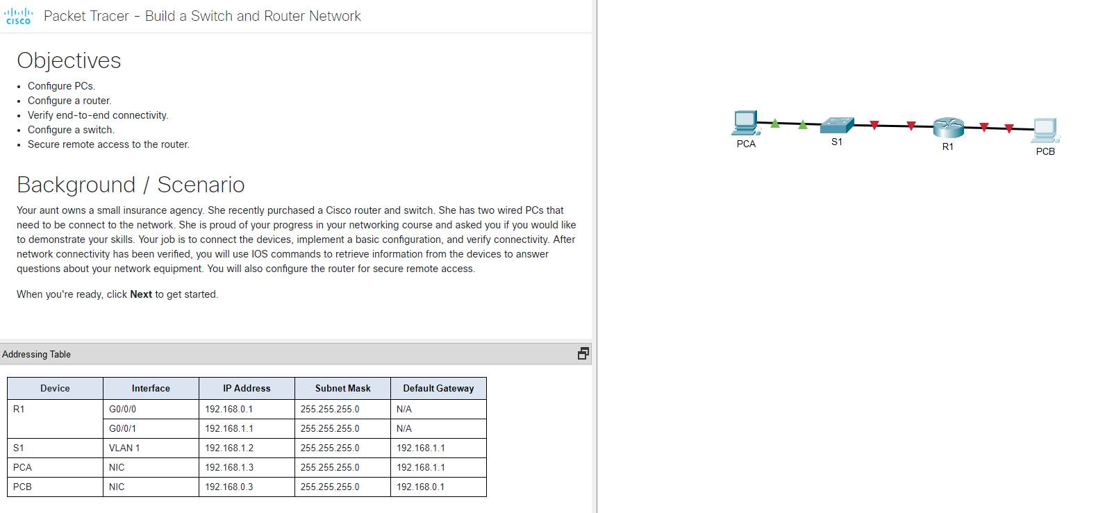

Hello everyone, I'm doing one cisco activity but I'm having a problem, I hope someone may help me.
- First step, I connect R1 to S1 by G0/0/1, PCA to S1 and PCB to R1 by G0/0/0 using Copper Straight Cable
- Second step, I configure ipv4, subnet mask and default gateway in PCA and PCB with the information shown on the table
- Then I am suposed to ping PCB from PCA but, as you can see in the image, my cables are red so is not working
4 RESPUESTAS 4
pieterh
did you power-on R1 ?
How should I turn it on? when I click on it I just have to write the comands and I do not know what to do there
pieterh
did you try right-click?
PC-B is dimmed, so this also looks powered down
Packet Tracer Official Tutorials
luis_cordova
Hello @Angelo96
I think the problem is that the router's interfaces aren't turned on.
Try these commands:
R(config)#interface g0/0/0
R(config-if)#no shutdown
R(config-if)#exit
R(config)#interface g0/0/1
R(config-if)#exit
I hope this helps.
Regards
