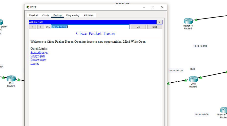

My local server does not work (I cannot go to the web page of this server from the 33.33.33.0 network), although I can from the 192 168.1.0 network, but there I use a gre tunnel, maybe problem in nat, in the middle I use ospf and announce other networks in ospf. Please help me

No...your problem was related to NAT. I fixed it by adding one line on the ACL. Check this out

Because you have a Static NAT, you need to call the Router IP address, not the server IP address
ip nat inside source list FOR-NAT interface GigabitEthernet0/0 overload
ip nat inside source list PUBLIC-ACCESS interface GigabitEthernet0/0 overload
ip nat inside source static tcp 192.168.0.10 80 10.10.10.5 80
ip classless
If you call the server on port 443, you can call the server directly. Because there will be no NAT on port 443
