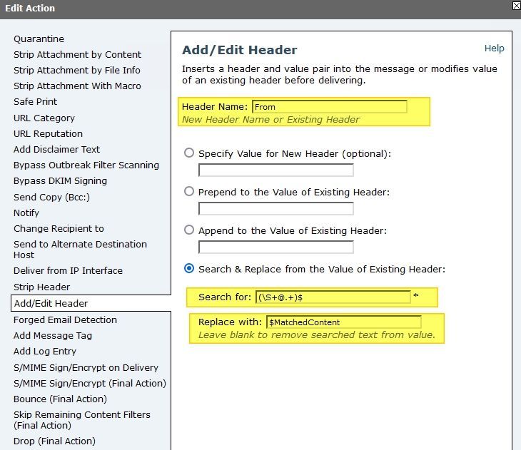

However, in the content filer rule, is this the correct way to fill in the fields according to your suggestion:

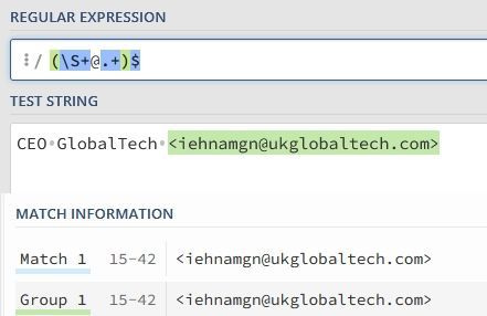

The regex filter (\S+@.+)$  does the job when I test it on a string:
I updated my content filter rule in the esa to reflect it:
Howerver, mails on which the mail policy applies still have the display name in the From field of the email.
