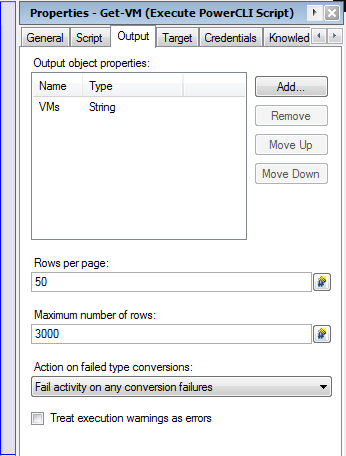

On the output tab of the PowerCLI activity I have attempted to add table columns for VM (name) and SizeGB (decimal) but when I run the process I get the following error:
PowerCLI script execution failed with the following:
Could not find a property named 'VM' while retrieving output values from the script results.
Now, if I remove those columns from the output tab of the PowerCLI activity and go to the Match Regular Expression activity and point it at [Workflow.Get-VM.Result_Table.Table_Data_XML] the RegEx activity just sees an empty table (even with the ECHO at the end of the PowerCLI activity)
Lastly, if I look at the results of the PowerCLI activity (Get-VM) it does say 3568 objects returned. This is about how many VMs I'd expect Get-VM to return - so the question is how do I get access to those objects in the next activity? I tried xpath query as well to no avail.
Some screenshots:
