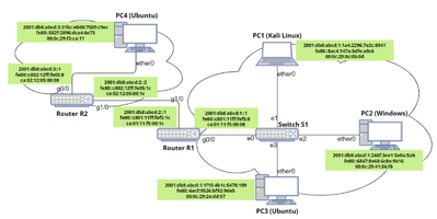

I have the following network topology in GNS3:
I want to stream a video from the source PC4 (Ubuntu) to all clients in the subnet 2001:db8:abcd:1::/64, and they are in the multicast group ff08::db8. What I know is that MLDv2 is configured in the local network 2001:db8:abcd:1::/64, and PIM need to be between router R1 and router R2. However, I dont understand how exactly is the configuration in these Cisco routers R1 and R2 to make things work. Can anyone please suggest or help me please? Thank you very much.

Thank you very much for your help. I followed your steps to configure and it worked when sending data from the source Ubuntu PC4 (which I set as server) to clients. However, the clients could not get the real-time data RTP from the streaming source when I used VLC. Maybe I had wrong configuration, so could you please flick through this configuration and give me some advice? The shortened configuration I had is down below:
---Router R1--- (Shortened output configuration)

The image of network topology is down below: scenario1.png
