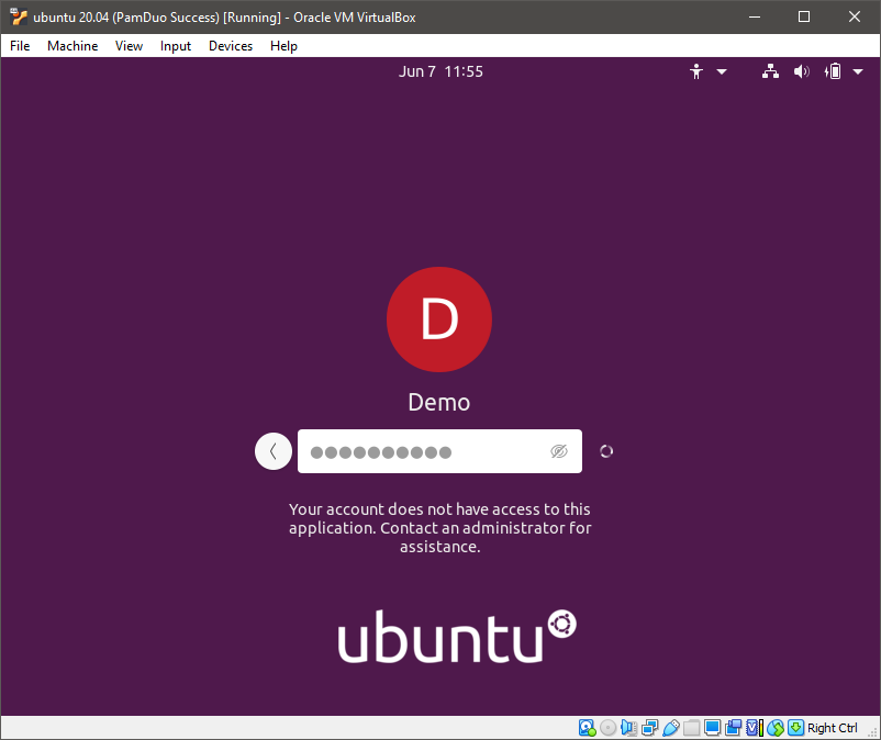

I have ran into another issue. I tried to access the Demo account and it shows this error:
When I enrolled the Demo user, I enrolled with the same device as my default user… Could it be that each Linux user is limited to one Duo Account?
The device to user limit and the user to device limit in Duo is 1:100 for both.
Did you configure permitted groups restrictions on your Duo Unix application in the Admin Panel? Is the Demo user a member of that permitted group in Duo?

Sorry for the late reply. But yes, I was able to configure the permitted group restrictions on my Duo application.
