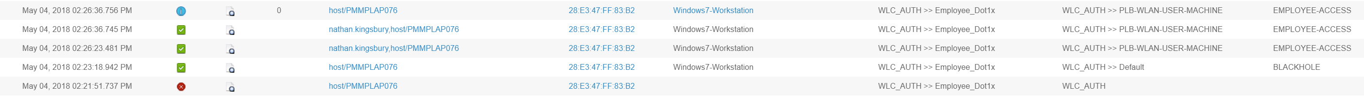

I am implementing an 802.1x environment using Cisco NAM for user+machine auth. I am using "Connect before Logon". When I put in my credentials and press enter I can immediately see the connection attempt in the ISE RADIUS logs, but it is only passing the host/machinename, which of course fails. It takes about three minutes before the machine passes username,host/machinename and then is connected.
Is there some way I can get the first connection request to pass the username and machinename?

Sorry, I will try to be more detailed. This is my first time deploying Cisco NAM and using EAP-FAST so perhaps I am missing something.
The authentication is done via AD username/pass and AD machine join. My authorization policy is set as "EAPChainingResult equals User and Machine both succeeed".
When the computer boots up and hits the log in screen, the host/machinename is set as the identity and it hits the BLACKHOLE policy. After the log in credentials are added, the NAM dialog box comes up and shows "Associating, Stopping" for the 40 second time period and the logs in. After a 30 seconds to 2 minutes after being at the windows desktop the username+machine name is passed as idenity and then the machine hits the EMPLOEE-ACCESS policy. Here is the connection from the the ISE log.
I guess what I am hoping for is that it will succeed on the first attempt and make the login process a bit shorter. With it doing the Associating, Stopping" for the 40 second, I have a feeling I am going to get some push back from the executives because its slowing down there log in process to much. I know I have the option to connect after logon, but I want network drives to attach properly.

You guys are brilliant! I created a new DACL allowing only authentication access to AD and set a policy to allow "user failed and machine passed". I could see that the computer would get that policy at login screen. Logging into the computer, the NAM dialog immediately showed "authenticating" and I can see the username,host\machine passed to ISE where it is authenticated and everything works perfectly.
