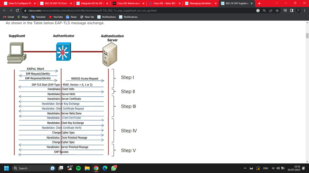

When i tried to capture the traffic is saw that my computer send his identity and get EAP Failure.

the SW enable 802.1x but the issue it stop at EAP-response Identity
This can from EAP method, the user send method that NOT match the EAP method.
so double check in NPS and user EAP method

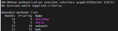

Check if the RADIUS request is reaching the NPS server. Also, check the output of "show authentication session int gig <id> detail" on the Cisco switch.

Try please to drop the keyword "detail" at the end of the "show authentication" command and share the output for review. You can also enable RADIUS authentication debugs on the switch "debug radius authentication" which should you if the comms with the NPS is working. Another thing you can do from the switch would be to show the aaa server status "show aaa servers" and look at the state lines, if it should show "current UP" it means the switch and the NPS can talk to each other. Finally you can enable the epm logging on the switch which would help you finding out any issue with the dot1x flows.
According to what you new share' and as @Nancy Saini mention' your SW never send request to aaa server.
Share config
