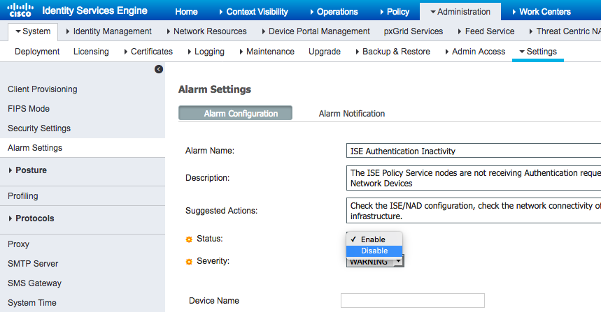

hslai
Go to the Alarm Settings page, select this alarm, edit its status to disable, and save.

hslai
Worked great for this.

Should you really disable the alarm? Is it just cosmetic? What if there is an issue that needs to be fixed in the network?
Under normal deployment functions it can certainly indicate a major problem if it suddenly starts. The reason this alarm is generated is because there is no radius authentication hitting a node, or the logging from that node has failed. This could indicate a network reachability issue, a load balancer issue, or something internal to ISE.
False positives are common if all your authentication uses the same node as primary. The secondary may report this alarm since nothing is configured to use it it unless the primary is down. If the load is balanced across the primary and secondary (or more nodes), then assuming radius hits the nodes at least once every 15 minutes, the alarm will not be triggered.
Disabling it is common since many use a primary/secondary, I suggest balancing the load either way.
