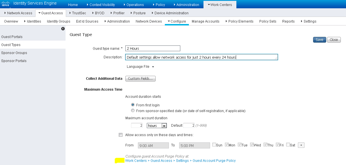

In ISE 2.1, Set the Guest Type (I would duplicate the Daily Guest and use the duplicate) by going to Work Centers > Guest Access > Configure > Guest Types.  Click the Guest Type you want to configure and select From first login.  Set the Maximum account duration to 2 hours and Default to 2.  Click Save.
Next, click the link on this page that is highlighted in the screenshot above to be taken to the Guest Account Purge Policy (You can also get there bu navigating to Work Centers > Guest Access > Settings > Guest Account Purge Policy). Under Schedule purge of expired guest accounts, select Purge occurs every: and set it to 1 days.
Then set the Time of purge: to midnight or a time close to midnight.

I don't think this solution covers what customer requires.
Currently we are running ISE server version 1.3, so we need to upgrade to which verion is recommended?
I understand this is for registered guests (webportal), we are using an AUP page where user only accepts policy and get connected?
The 2h connection time within 24h is not fullfilled here, as the purge takes place every midnight, but it might do for the customer. Any other possible solution (something like: after connecting 24h purge timer starts)?
