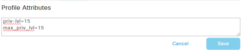

that doesnt matter I think as aruba clearpass can pass priv 15 under enforcement profiles->priv level->selected services=shell

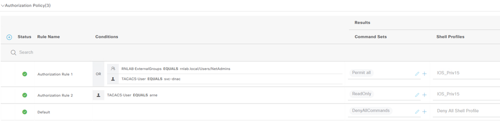

What happens next, depends on how you have configured your IOS. Do you want EVERY command to be authorized as well?  If yes (e.g. for RBAC reasons), the IOS "aaa authorization commands" do just that - but - it must be done for every priv level possible. In my experience, even though you are authorized to priv15, some commands you enter, are lower priv - therefore, to catch those, cater for priv0,1,15 commands.
Going back to ISE config, in the TACACS+ Policy Set I made two Authorization scenarios - super admins, and readonly admin - here is what it looks like in ISE (Clearpass does the same thing, but looks different)

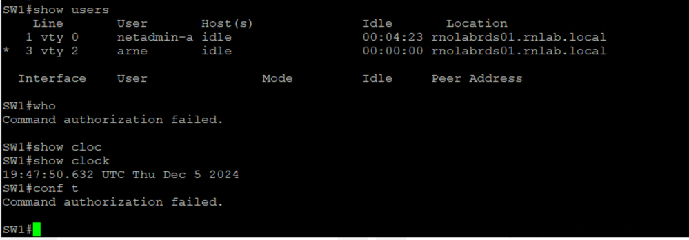

When I login as the user 'arne', my experience is as follows
And you can see ISE is authorizing every command I type

But since I am no longer authorizing the priv0/1 commands, I can suddenly issue them as user 'arne', even though my TACACS+ server has rules to not allow this - the reason is simple - IOS no longer makes those requests to the server. The command 'who' is not allowed in my TACACS+ server, but the user can now execute it:
Command authorization has less to do with what Priv Level I gave the user, but it's more concerned with what Priv Level the command is, that I have just entered into the shell.  I have yet to see a complete listing (or a command in IOS) that shows what priv level is needed for which command.
