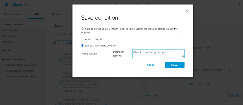

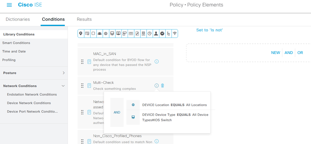

Hello
ISE 3.x has undergone a few UI changes but the functionality is still there. Compound Conditions is just a fancy word for a condition that is made up of two or more conditions and then given a name that you can use to refer to it - very useful if you have to re-use the same set of conditions many times over. The Library is where you go to look for existing Compound Conditions, and you can also create your own. Just create one and then click the 'Save' button - it will ask you for a name. The Save button is often confused for the 'Use' button further down below, which saves&applies the condition.
