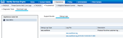

ISE has local logging although it disabled by default for Passed Authentications. We may go to ISE Admin Web UI > Administration > System > Logging > Logging Categories. Select Passed Authentications and put a check mark on [ V ] Local Logging.

Then, we may either download the file(s) at ISE Admin WebUI > Operations > Troubleshoot > Download Logs > [ISE node name] > Debug logs.
Or, use ISE Admin CLI to tail on it.
myISE/admin# terminal length 0
myISE/admin# show logging application localStore/iseLocalStore.log tail
