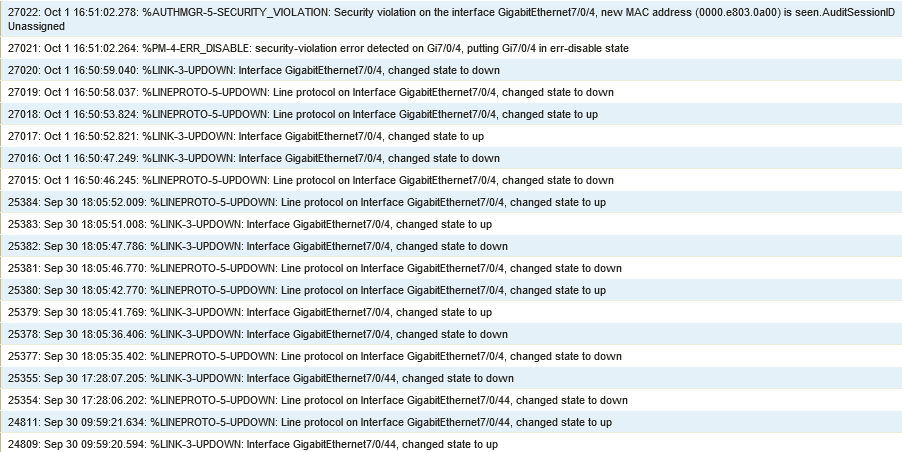

Recently, one port on our 9200 switch went to err-disable state and the status LEDs are all off.
The port configuration is as below: it is connected to a desktop PC
The logs is as below, it looks before it goes to err-disable state, the port up and down for many times. seems the user was rebooting the machine

"Date","Time","Facility","Level","Host Name","Message Text"
"2024-10-09","17:22:43","Local7","Notice","10.2.9.5","37464: Oct 9 17:22:43.162: %LINEPROTO-5-UPDOWN: Line protocol on Interface GigabitEthernet8/0/41, changed state to up"
"2024-10-09","17:22:43","Local7","Error","10.2.9.5","37463: Oct 9 17:22:42.162: %LINK-3-UPDOWN: Interface GigabitEthernet8/0/41, changed state to up"
"2024-10-09","17:22:39","Local7","Error","10.2.9.5","37462: Oct 9 17:22:38.936: %LINK-3-UPDOWN: Interface GigabitEthernet8/0/41, changed state to down"
"2024-10-09","17:22:38","Local7","Notice","10.2.9.5","37461: Oct 9 17:22:37.932: %LINEPROTO-5-UPDOWN: Line protocol on Interface GigabitEthernet8/0/41, changed state to down"
"2024-10-09","17:22:33","Local7","Notice","10.2.9.5","37460: Oct 9 17:22:33.894: %LINEPROTO-5-UPDOWN: Line protocol on Interface GigabitEthernet8/0/41, changed state to up"
"2024-10-09","17:22:33","Local7","Error","10.2.9.5","37459: Oct 9 17:22:32.893: %LINK-3-UPDOWN: Interface GigabitEthernet8/0/41, changed state to up"
"2024-10-09","17:22:28","Local7","Error","10.2.9.5","37458: Oct 9 17:22:27.552: %LINK-3-UPDOWN: Interface GigabitEthernet8/0/41, changed state to down"
"2024-10-09","17:22:27","Local7","Notice","10.2.9.5","37457: Oct 9 17:22:26.557: %LINEPROTO-5-UPDOWN: Line protocol on Interface GigabitEthernet8/0/41, changed state to down"
"2024-10-09","09:55:45","Local7","Notice","10.2.9.5","36587: Oct 9 09:55:44.726: %LINEPROTO-5-UPDOWN: Line protocol on Interface GigabitEthernet8/0/41, changed state to up"
"2024-10-09","09:55:44","Local7","Error","10.2.9.5","36586: Oct 9 09:55:43.724: %LINK-3-UPDOWN: Interface GigabitEthernet8/0/41, changed state to up"
"2024-10-09","09:55:36","Local7","Error","10.2.9.5","36583: Oct 9 09:55:35.900: %LINK-3-UPDOWN: Interface GigabitEthernet8/0/41, changed state to down"
"2024-10-09","09:55:33","Local7","Notice","10.2.9.5","36581: Oct 9 09:55:32.588: %LINK-5-CHANGED: Interface GigabitEthernet8/0/41, changed state to administratively down"
"2024-10-09","09:55:28","Local7","Notice","10.2.9.5","36579: Oct 9 09:55:27.970: %PARSER-5-CFGLOG_LOGGEDCMD: User:admin logged command:interface GigabitEthernet8/0/41 "
"2024-10-08","16:46:47","Local7","Notice","10.2.9.5","35580: Oct 8 16:46:46.048: %AUTHMGR-5-SECURITY_VIOLATION: Security violation on the interface GigabitEthernet8/0/41, new MAC address (0848.8905.3e52) is seen.AuditSessionID Unassigned"
"2024-10-08","16:46:46","Local7","Warning","10.2.9.5","35579: Oct 8 16:46:46.031: %PM-4-ERR_DISABLE: security-violation error detected on Gi8/0/41, putting Gi8/0/41 in err-disable state"
"2024-10-08","16:46:43","Local7","Error","10.2.9.5","35578: Oct 8 16:46:42.796: %LINK-3-UPDOWN: Interface GigabitEthernet8/0/41, changed state to down"
"2024-10-08","16:46:42","Local7","Notice","10.2.9.5","35577: Oct 8 16:46:41.794: %LINEPROTO-5-UPDOWN: Line protocol on Interface GigabitEthernet8/0/41, changed state to down"
"2024-10-08","16:46:38","Local7","Notice","10.2.9.5","35576: Oct 8 16:46:38.830: %LINEPROTO-5-UPDOWN: Line protocol on Interface GigabitEthernet8/0/41, changed state to up"
"2024-10-08","16:46:38","Local7","Error","10.2.9.5","35575: Oct 8 16:46:37.829: %LINK-3-UPDOWN: Interface GigabitEthernet8/0/41, changed state to up"
"2024-10-08","16:46:31","Local7","Error","10.2.9.5","35574: Oct 8 16:46:31.625: %LINK-3-UPDOWN: Interface GigabitEthernet8/0/41, changed state to down"
"2024-10-08","16:46:31","Local7","Notice","10.2.9.5","35573: Oct 8 16:46:30.627: %LINEPROTO-5-UPDOWN: Line protocol on Interface GigabitEthernet8/0/41, changed state to down"
"2024-10-08","09:39:51","Local7","Notice","10.2.9.5","35107: Oct 8 09:39:51.062: %LINEPROTO-5-UPDOWN: Line protocol on Interface GigabitEthernet8/0/41, changed state to up"
"2024-10-08","09:39:51","Local7","Error","10.2.9.5","35106: Oct 8 09:39:50.060: %LINK-3-UPDOWN: Interface GigabitEthernet8/0/41, changed state to up"
"2024-10-08","09:39:47","Local7","Error","10.2.9.5","35105: Oct 8 09:39:46.725: %LINK-3-UPDOWN: Interface GigabitEthernet8/0/41, changed state to down"
"2024-10-08","09:39:46","Local7","Notice","10.2.9.5","35104: Oct 8 09:39:45.721: %LINEPROTO-5-UPDOWN: Line protocol on Interface GigabitEthernet8/0/41, changed state to down"
"2024-10-08","09:39:38","Local7","Notice","10.2.9.5","35103: Oct 8 09:39:38.727: %LINEPROTO-5-UPDOWN: Line protocol on Interface GigabitEthernet8/0/41, changed state to up"
"2024-10-08","09:39:38","Local7","Error","10.2.9.5","35102: Oct 8 09:39:37.725: %LINK-3-UPDOWN: Interface GigabitEthernet8/0/41, changed state to up"
"2024-10-08","09:39:32","Local7","Error","10.2.9.5","35101: Oct 8 09:39:31.529: %LINK-3-UPDOWN: Interface GigabitEthernet8/0/41, changed state to down"
"2024-10-08","09:39:31","Local7","Notice","10.2.9.5","35100: Oct 8 09:39:30.572: %LINEPROTO-5-UPDOWN: Line protocol on Interface GigabitEthernet8/0/41, changed state to down"
"2024-10-04","17:11:08","Local7","Notice","10.2.9.5","32778: Oct 4 17:11:07.805: %LINEPROTO-5-UPDOWN: Line protocol on Interface GigabitEthernet8/0/41, changed state to up"
"2024-10-04","17:11:07","Local7","Error","10.2.9.5","32777: Oct 4 17:11:06.808: %LINK-3-UPDOWN: Interface GigabitEthernet8/0/41, changed state to up"
"2024-10-04","17:11:04","Local7","Error","10.2.9.5","32776: Oct 4 17:11:03.592: %LINK-3-UPDOWN: Interface GigabitEthernet8/0/41, changed state to down"
"2024-10-04","17:11:03","Local7","Notice","10.2.9.5","32775: Oct 4 17:11:02.589: %LINEPROTO-5-UPDOWN: Line protocol on Interface GigabitEthernet8/0/41, changed state to down"
"2024-10-04","17:10:58","Local7","Notice","10.2.9.5","32773: Oct 4 17:10:58.714: %LINEPROTO-5-UPDOWN: Line protocol on Interface GigabitEthernet8/0/41, changed state to up"
"2024-10-04","17:10:58","Local7","Error","10.2.9.5","32772: Oct 4 17:10:57.714: %LINK-3-UPDOWN: Interface GigabitEthernet8/0/41, changed state to up"
"2024-10-04","17:10:52","Local7","Error","10.2.9.5","32771: Oct 4 17:10:52.396: %LINK-3-UPDOWN: Interface GigabitEthernet8/0/41, changed state to down"
"2024-10-04","17:10:52","Local7","Notice","10.2.9.5","32770: Oct 4 17:10:51.397: %LINEPROTO-5-UPDOWN: Line protocol on Interface GigabitEthernet8/0/41, changed state to down"
"2024-10-04","14:31:50","Local7","Notice","10.2.9.5","32693: Oct 4 14:31:50.942: %LINEPROTO-5-UPDOWN: Line protocol on Interface GigabitEthernet8/0/41, changed state to up"
"2024-10-04","14:31:50","Local7","Error","10.2.9.5","32692: Oct 4 14:31:49.940: %LINK-3-UPDOWN: Interface GigabitEthernet8/0/41, changed state to up"
"2024-10-04","14:31:47","Local7","Error","10.2.9.5","32691: Oct 4 14:31:46.717: %LINK-3-UPDOWN: Interface GigabitEthernet8/0/41, changed state to down"
"2024-10-04","14:31:46","Local7","Notice","10.2.9.5","32690: Oct 4 14:31:45.712: %LINEPROTO-5-UPDOWN: Line protocol on Interface GigabitEthernet8/0/41, changed state to down"
"2024-10-04","14:31:41","Local7","Notice","10.2.9.5","32689: Oct 4 14:31:41.986: %LINEPROTO-5-UPDOWN: Line protocol on Interface GigabitEthernet8/0/41, changed state to up"
"2024-10-04","14:31:41","Local7","Error","10.2.9.5","32688: Oct 4 14:31:40.985: %LINK-3-UPDOWN: Interface GigabitEthernet8/0/41, changed state to up"
"2024-10-04","14:31:36","Local7","Error","10.2.9.5","32687: Oct 4 14:31:35.513: %LINK-3-UPDOWN: Interface GigabitEthernet8/0/41, changed state to down"
"2024-10-04","14:31:35","Local7","Notice","10.2.9.5","32686: Oct 4 14:31:34.509: %LINEPROTO-5-UPDOWN: Line protocol on Interface GigabitEthernet8/0/41, changed state to down"
"2024-10-03","16:49:23","Local7","Notice","10.2.9.5","31747: Oct 3 16:49:22.984: %LINEPROTO-5-UPDOWN: Line protocol on Interface GigabitEthernet8/0/41, changed state to up"
"2024-10-03","16:49:23","Local7","Error","10.2.9.5","31746: Oct 3 16:49:21.981: %LINK-3-UPDOWN: Interface GigabitEthernet8/0/41, changed state to up"
"2024-10-03","16:49:19","Local7","Error","10.2.9.5","31745: Oct 3 16:49:18.744: %LINK-3-UPDOWN: Interface GigabitEthernet8/0/41, changed state to down"
"2024-10-03","16:49:18","Local7","Notice","10.2.9.5","31744: Oct 3 16:49:17.740: %LINEPROTO-5-UPDOWN: Line protocol on Interface GigabitEthernet8/0/41, changed state to down"
"2024-10-03","16:49:10","Local7","Notice","10.2.9.5","31743: Oct 3 16:49:10.859: %LINEPROTO-5-UPDOWN: Line protocol on Interface GigabitEthernet8/0/41, changed state to up"

Hi
Thanks very much for your reply.
It happened again today, with another new MAC address been seen. That's very strange, I can't find the new MAC coming from where...
We don't have IP phones or HUB or deck for the PC.
Maybe we can set it to  authentication violation restrict or replace, because we use Windows 10 machine certificate and user certificate for authentication, we don't mind what MAC address it is.
117222400
I tested again, the port doesn't have any "sticky" feature, as I used 2 different usb network adaptor to connect to the same port. They have different MAC addresses and both got DHCP IP and working properly.
Just suspect where is the new MAC coming from, only 2 adaptors on the PC, one is the normal one, another is the Zscaler adaptor, none of them have the above detected "new MAC is seen.." that's very odd.
117222400
Today morning the issue happened again. The same issue same desktop, and we can see that there are some up and downs yesterday afternoon, the last state at yesterday is UP, and suddenly it went to err-disable at today morning, other new MAC address appeared. The user is working from home and RDP to the desktop. no other devices at all.. where is the MAC address from..
I found this bug: https://bst.cisco.com/quickview/bug/CSCus17694 but our version is:
Cisco IOS XE Software, Version 17.09.04a
Cisco IOS Software [Cupertino], Catalyst L3 Switch Software (CAT9K_LITE_IOSXE), Version 17.9.4a, RELEASE SOFTWARE (fc3)
is it possible to verify whether the  memory is leaky or not , when it happened or after I fixed it?
A work around might be setup the err-disable recovery to 5 seconds?
