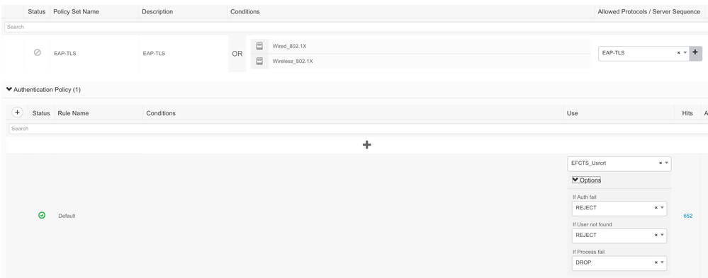

Can you send us the screenshot of the authentication policies you have configured and also the screenshots of identity source sequences you have used in respective authentication policies?
All Auth rulesAll Auth rulesPEAPPEAPEAP-TLSEAP-TLS

From the screenshot that was sent, It seems like you have explicitly configure separate rules for each protocol. What I am suggesting is to use one rule for all types of EAP methods.
