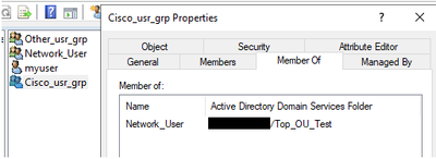

My goal is to have a user belonging to a specific group in which other groups are member of and retrieve them on ISE. For example :
I have my user 'myuser' who belongs to Network User group :
I also have "Cisco" and "Other" which are members of "Network_User" :
My goal is to say if myuser is a network_user, since other and cisco are members of network_user myuser will be implicitly member of Cisco and Other. With that i would like to permit all Network_Users to be part of Cisco and Other groups and also give me the possibility to add users from others group to be member of "Cisco" or "Other" group without being in Network User.

thomas
I have recreated your AD group structure:
- Network_User
  - Cisco
    - cisco_user
  - Other_Vendor
  - myuser
+Add the AD Groups to ISE:
Then go test the user as @Arne Bier suggested:
and I get:
hslai
@k2no The LDAP ID sources in ISE do not support nested group membership lookups. Please create them as AD join points, instead.
