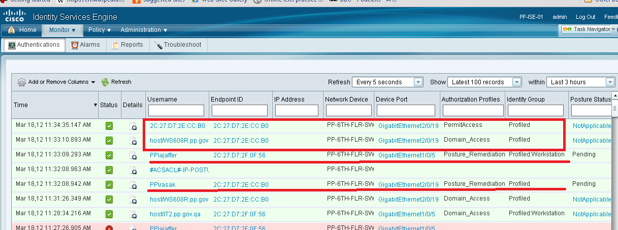

We have cisco Identity Service Engine (ISE) with Active/Standby deployment with the version 1.1.0.665 on both.
We can see the number of alarms geneated so far in >60000 and every 2 minutes time we get one alarm on the dashboard saying "Alarm caused by ISE - System Health Issue".
Can anyone please advise what is the exact reason, whether it is false alarm, will this affect for the live users, is there a patch to resolve this issue?.
Please see the attached are taken from the ISE.

I am not sure either of the screen shots show the reason for the alarm
