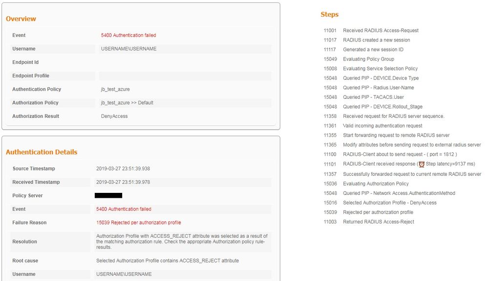

However, the ISE server then logs an authentication failure (rejected as per authorization profile) showing the username as "USERNAME\USERNAME" rather than the real username that was sent to NPS - the real username is shown in the NPS logs so I know it is being sent over correctly, processed etc. (You can see my domain name starts UK in the NPS log below)
The radius request id in the access-request packet sent to the NPS matches the id in the access-accept packet returned. My "Radius Server Sequences" has a tick for "On Access-Accept, continue to Authorization Policy" so that does agree that we are hitting my authorization policies that checks the user membership of a specific AD group - but with the wrong username, this fails and it drops out with the DenyAccess from the default Authorization.ISE.jpg

hslai
I would suggest to start with Solved: Client Authenticating Incorrectly in IS... - Cisco Community.
And, examine your authorization policy rules and see any reason why nothing matched other than the default, which results in Deny-Access.

Thanks so much - I have seen that Radius option before but didn't event think of using it. A search for "USERNAME/USERNAME" doesn't help either. That other community post was perfect explanation of this feature!
Long and short from my side was the masking of the username meant I was unable to see that the user that was failing was due to not being a member of the VPN users group.
Simple answer, simple solution.
Many thanks!
