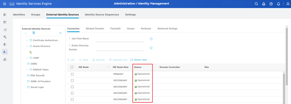

01-15-2025 06:18 PM
Hi @Saeed Abd Elhalim Hamada ,
1st, take a look at Administration > System > Deployment, if all Node Status are Connected.
2nd, take a look at Administration > Identity Management > External Identity Sources, if all Status are Operational.
Hope this helps !!!
