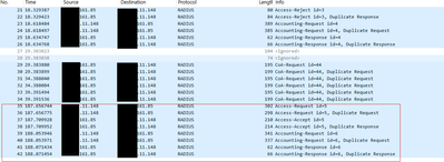

The take a closer look i've made a pcap and I have let it run until the client got authenticated again (hiding first 2 octets for privacy):
It seems that it does send the CoA that's triggered by the default 'Endpoint Delete' profiler exception action.  As you can see it gets acknowledged as well. After that I see a bunch of new CoA requests, all containing VSA: t=Cisco-AVPair(1) l=35 val=subscriber:command=reauthenticate, but the switch never sends an ACK on those.   Even though it doesn't acknowledge the last, the supplicant still gains access after waiting for ~15 minutes. Manually triggering CoA's from the end point store also seems to work (getting ack's on those) .
Any idea?
The Wireshark decode is quite revealing. I have had many issues with Meraki and its RADIUS implementation (esp the MS390 - what an awful product) - they often lack features that Cisco switches have had for over 10 years, and then still contain many bugs. I'd open a ticket with Meraki. Not responding to a CoA is a bug. If the NAD believes the CoA was sent in error, it must respond with a CoA NAK. I see those sent by Catalyst switches. I assume you've checked the Meraki release notes or tried to update the switch as well?
Do you know why you have so many duplicate packets shown in your Wireshark?

After I delete the supplicant from the endpoint store, it is issueing a CoA which contains both the subscriber command and the audit session ID. Shortly after this, ISE is sending CoA reauthentication requests again, but they do not contain the audit-session-id.  So I think the switch doesn't know for which client the CoA is destined for, according to the RFC the Meraki switch should reply with a NAK, bit Meraki seems to just ignore it...  According to the Meraki documentation, the Session ID is learned from the original Radius access accept message, the thing is that my device gets a rejected the 1th time (Acces-Reject), so that might be the reason it doesn't supply the CoA with a audit-session-id (?).
How I reproduce it:
1. Delete supplicant from endpoint store, this is triggering a CoA reauthentication request, which is getting acknowledged by the Meraki switch. Switchport reauthentication is triggered and the supplicant is performing an Access-request again.
2. Endpoint shows up again in endpoint store, gets rejected by the default deny authorization policy. In the PCAP an access-request and access-reject is seen
3. After that the supplicant stays unauthenticated for quite some time. CoA requests are seen at this point, they do not contain a audit-session-ID. These packets do arrive at the Meraki switch but an ACK/NAK is never given.
4. After manually cycling the port, or waiting for the supplicant to reauthenticate on its own again, a new access-request is being made, responded with Access-Accept, which contains the correct profile. The client works now.
I'm still looking into the duplicated packets, not sure what is causing that.
