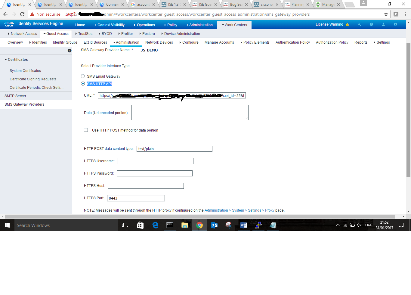

Hi Rahul, thanks for the reply.
I am using an SMS HTTP API ( please take a look at the screenshot), as long as I the account is in an "actif" state the ISE sends an sms, otherwise ( state created), the ise does not.
