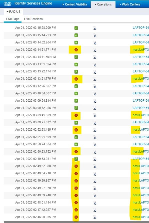

Hi All,
Apologies if this is in the incorrect place - just wondering if somebody could help explain something. We have a wireless network which is managed and maintained by the local authority - the WLC is located remotely (Catalyst 9800-80) along with the ISE server.
I have limited access to viewing logs on ISE and I do have limited access to Cisco Prime to view things - we don't have any access to the config / setup.
Our clients connect to 9120AXI-E Access Points - Throughtout the day we have major issues with devices not being able to connect - this tends to happen more when they are roaming across the building - and can then take quite sometime to re-connect. When I look at the ISE Live log files I see the following... Could somebody tell me what the difference is between the one's listed as HOST\laptopname that keep showing up with a red cross and those that just have the laptop name that have green ticks - the MAC address against the two are the same.
Why are some listed as HOST\name and others not?? - How do we fix this if it is a problem.
Thanks
Matt

And for anyone reading this far. The Windows eventlog which could have shown the error (CRL checks failing/timing out) is
"Applications and Service Logs/Microsoft/Windows/CAPI2/Operational"
You have to enable it first (which requires local admin rights), and then it will tell you all the details that the regular "Wired-Autoconfig" and "WLAN-Autoconfig" doesn't show.
