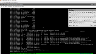

Hi i`m trying to Re-Image Cisco ISE Appliance
SNS-3615-K9
 Ver3.3
but this error keep shown to me  i try to run the image vie KVM map and also Flash
Thanks for all comment , solved CIMC IP need to reach internet so ISE can download the package and install it

It reads as if it failed while writing/installing the boot loader (Grub?).  I'd suggest you check the CIMC for IO/DIsk/Raid errors, then call Cisco TAC.

I wonder if it would have got this far if there was an issue with the ISO file?
It's worth running an MD5 checksum of the ISO file on the machine that you're mounting the ISO via the CIMC virtual KVM

i check the sum and not currapted , the SNS was work and after upgrade the MNT shown error and i open TAC and after 2 month with cisco TAC they told me to re-image  , and when i re-image this problem apears to me
Here main, log , storage log , program log
2025-01-09 10_50_32-C220-WMP242201ZK - KVM Console — Mozilla Firefox-logs.png

Hardware appliances are supposed to make life easier/simpler. But when you have issues with the install, then maybe take a closer look at the CIMC screens, and look for error/diagnostic messages in the logs.
Maybe the HDD has some sector errors ?  It might be quicker to engage the TAC and let them diagnose this - in the end you might need to RMA the appliance.
Did you perhaps attempt to update the BIOS/CIMC firmware since you got this appliance?  The SNS is a UCS server, but ISE won't work unless you take the firmware images located in the ISE downloads page - putting any old random firmware on an SNS server can render it useless.
