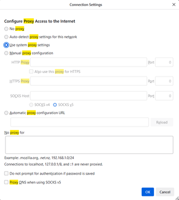

Yes, you are right I have proxy configurations on Browser, I removed it, but still not working.
But I noticed that my computer has this below configuations:
  1. Is there a way to check if I have proxy configurations enabled?
  2. If yes, what should I do to be able to use the FQDN of the sponsor portal?
Thank you in advance
Dustin Anderson
you can try to turn off the auto detect for the test and if it works it tells you the proxy is getting sent by DHCP.
